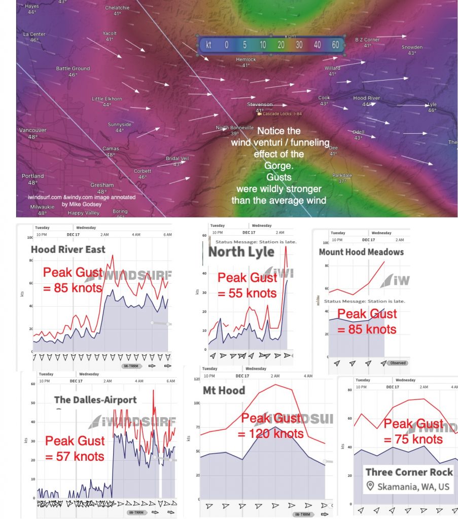

Up at ≈ 18,000 feet aloft (500 MB) a humongous atmospheric river stretches over 10,000 miles from Egypt to near Canada today. You can see this in this modeled imagery of the winds s at ≈ 18,000 feet aloft (500 MB). As this narrow band of strong winds travels across the warm Pacific it picks…

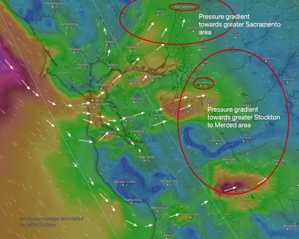

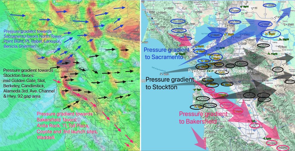

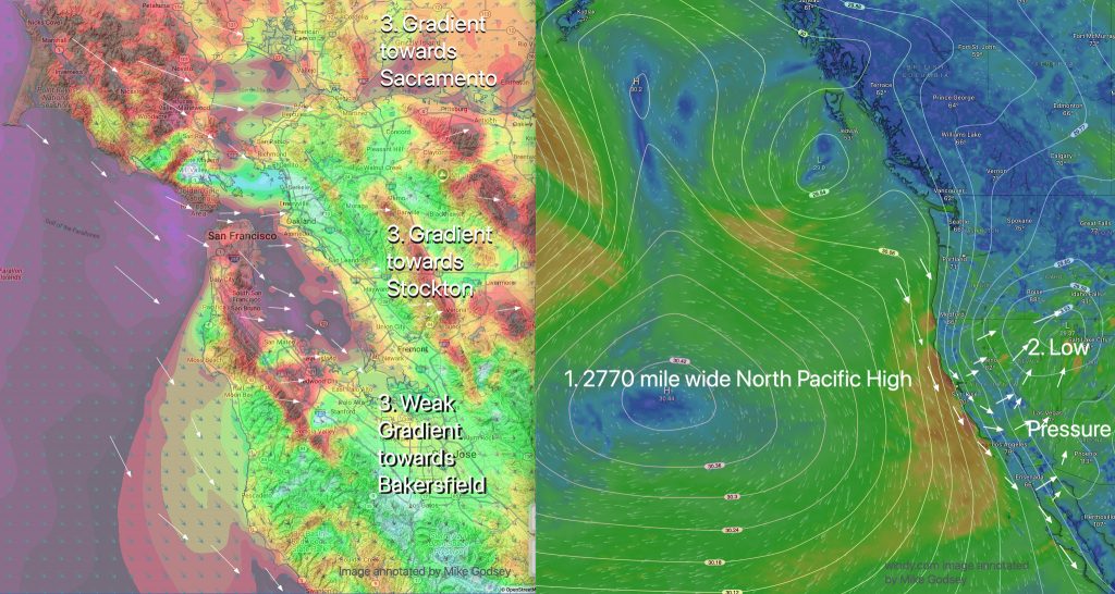

Back in beach Meteorology 101 you probably learned that wind is created as air moves from high-pressure towards low-pressure. Every sunny day at our beaches you can see and feel this happen as the Coastal Valleys heat and mild winds ramp up. But these local scale winds are much weaker than the strong winds created…

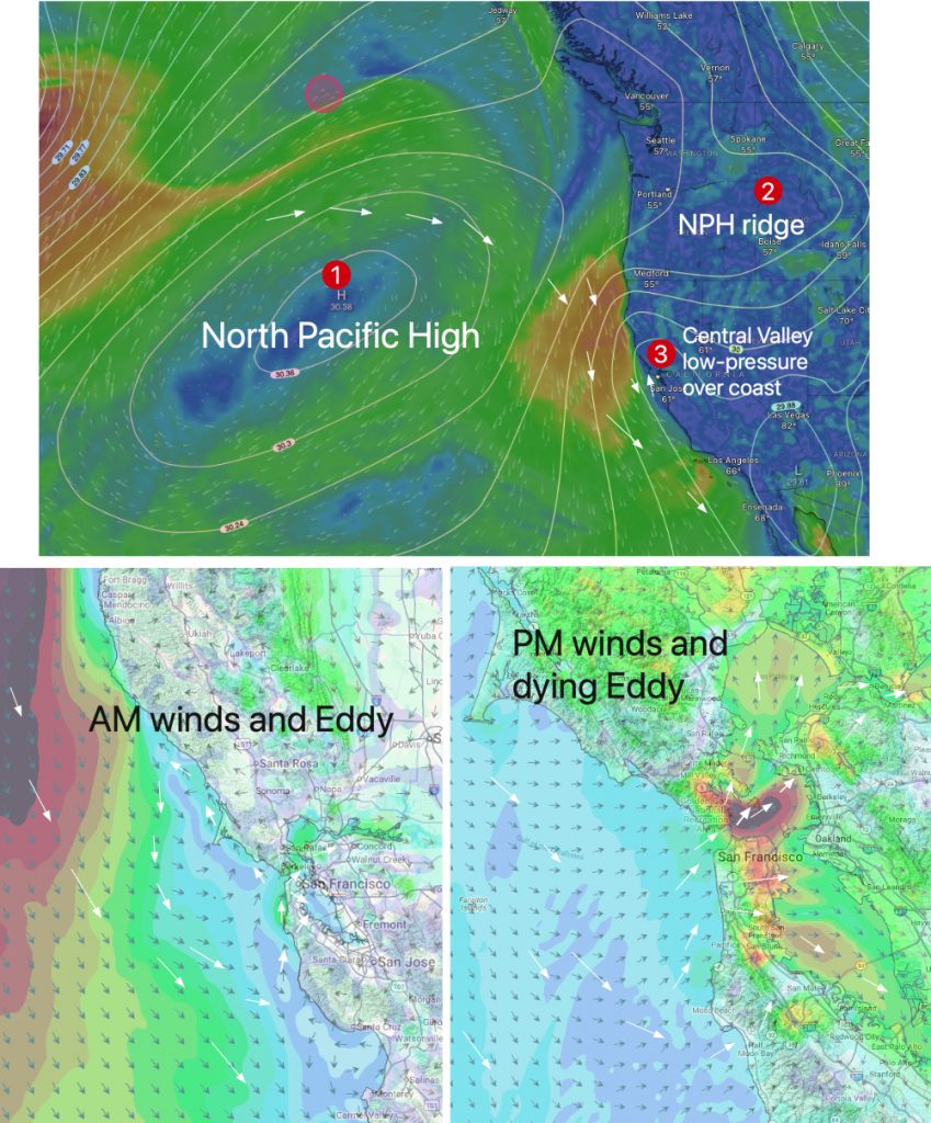

Forecast Decoder: The North Pacific High is slowly gathering its strength west of Baja and the Pacific side sees mid-teens NW wind today. A bit of that wind reaches the Sea of Cortez as NNW wind that barely reaches the sand. The model output suggests cloud coverage all day but in the satellite imagery, I…
